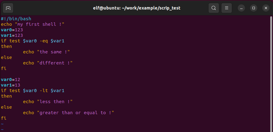

举例,在myshell.sh脚本中加入如下内容,将两个变量值进行比较:
var0=123
var1=123
if test $var0 -eq $var1
then
        echo "the same !"
else
        echo "different !"
fi
var0=12
var1=13
if test $var0 -lt $var1
then
        echo "less then !"
else
        echo "greater than or equal to !"
fi

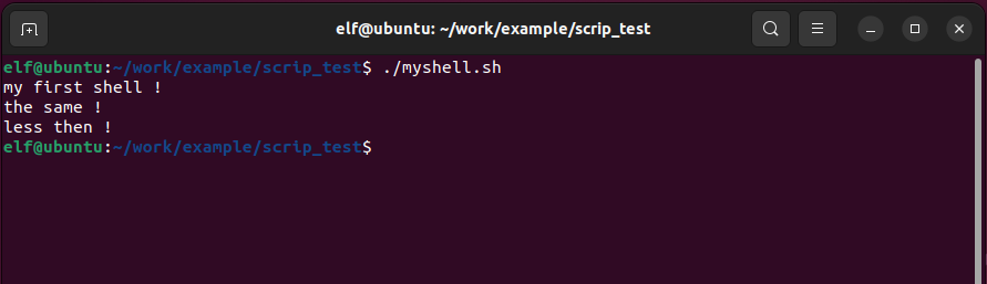

执行结果:

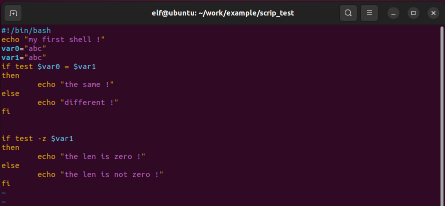

举例,在myshell.sh中添加如下内容,进行变量值比较:
var0="abc"
var1="abc"
if test $var0 = $var1
then
        echo "the same !"
else
        echo "different !"
fi
if test -z $var0
then
        echo "the len is zero !"
else
        echo "the len is not zero !"
fi

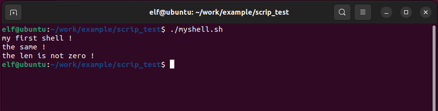

执行结果如下:

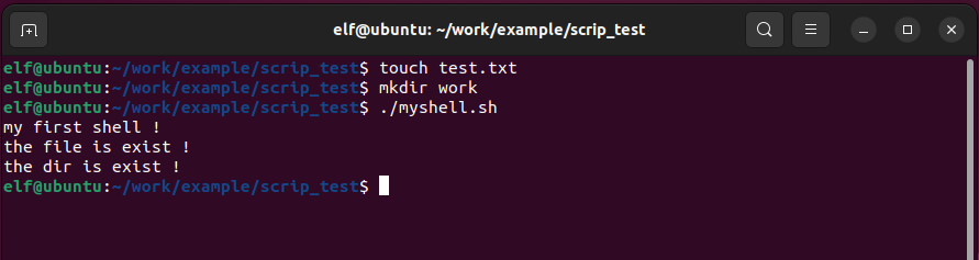

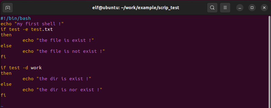

举例,首先建立test.txt文件和work文件夹,然后在myshell.sh脚本中加入如下内容,来判断是否存在test.txt文件和work文件夹:
if test -e test.txt
then
        echo "the file is exist !"
else
        echo "the file is not exist !"
fi
if test -d work
then
        echo "the dir is exist !"
else
        echo "the dir is nor exist !"
fi
执行结果如下:

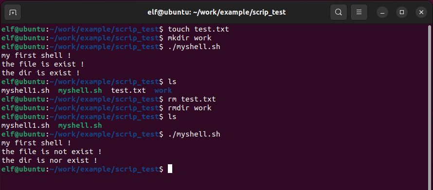

删除创建的test.txt文件和work目录,执行结果如下:
