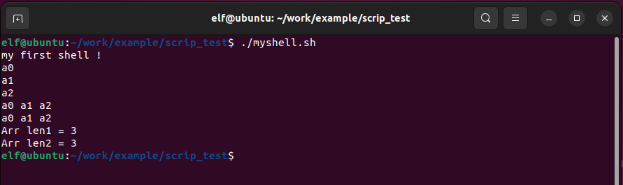

数组长度获取使用$${#Arr[* ]}或者${#Arr[@]},在脚本中加入:
Arr=(a0 a1 a2)
echo ${Arr[0]}
echo ${Arr[1]}
echo ${Arr[2]}
echo ${Arr}
echo ${Arr[@]}
echo "Arr len1 = ${#Arr}"
echo "Arr len2 = ${#Arr[@]}"
执行脚本,可以看到数组大小为3:
